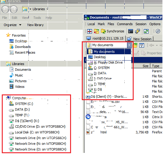

Re: Mapped network-drives not visible in list of local drives
Can you see the other drives in Windows Explorer?
I have the same problem.
Version 5.7.3 (Build 5438).
I just see my local drives but not the network drives.
I am using Commander interface.
I have tested using as administrator or not and this is similar, I don't see network drives.
Any idea?
Murz

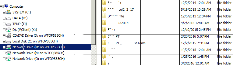

To explain the situation :
We are connected on machine WTOPS85CH.
Then we run a Citrix connection to another server from where we use WinSCP.
That's why we can see two C: drives (first one is the local C: of connected server, the second one is the C: from the original server).
From this connected server where we use WinSCP, in Explorer M: is a Network Drive and is accessible (check attachment1).
But in DOS, this M: is not visible :
D:\>dir M:\
The system cannot find the path specified.
D:\>
So do you think I can find a tip to see them in WinSCP?
Thanks
Murz
I do not know how Citrix works.
To see a drive in WinSCP you have to map it to a drive letter. Those drives are not mapped (contrary to the subject of this topic).
