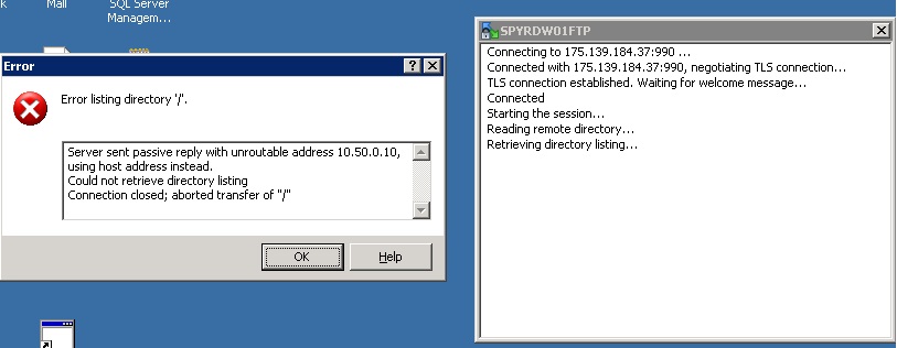

Hi, I got an error mentioning this error when I connected to the hostname.
Protocol is FTPS Explicit in GUI mode.
Server sent passive reply with unroutable address 10.50.0.10, using host address instead.
Could not retrieve directory listing
Connection closed; aborted transfer of "/"
Any idea how to resolve this?

-Refer To Attachment for Screenshot
Description: WinSCP Error.

@Innersphere: Please attach a full log file showing the problem (using the latest version of WinSCP).
Also attach a corresponding log file from FileZilla.

Re: FTPS Explicit error - Error listing directory '/'.
Thanks. Though I can connect without any problem.
Do you have the problem when connecting from other machines/networks? It's possible that the connection is blocked by your local firewall (you might have a firewall rule that allows FileZilla)
Hi, I receive a similar error when I try to connect the WinSCP to a Windows 2012 R2 IIS FTP server

Makc666
50
MSK-RU
Re: Server sent passive reply with unroutable address
@keny2020j: You need to setup your IIS FTP server to correctly handle Passive mode.
In "FTP Firewall Support" section setup "Data Channel Port Range".
Also you can setup "External IP Address of Firewall" there.
Also for each site you can set its own "External IP Address of Firewall" also in "FTP Firewall Support" section but in that site's section.
https://learn.microsoft.com/en-us/previous-versions/windows/it-pro/windows-server-2012-r2-and-2012/hh831817(v=ws.11)
