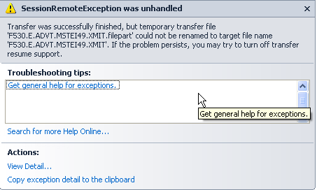

Hi we have been using the .Net libary and written a function with the help of your fantastic documentation,
We have recently encountered a problem with sending our file using sftp, it turns out our vendor have made changes there end that doesn't allow transfer resume, they have said its a large change to turn the facility of and asked us to change our end.....
After reading and searching through the libarys i cannot find a property that will allow that feature to be disabled, if anyone can help that would be greatly appreciated, i really don't want to use another application as WinSCP has been superb since we started using it.
