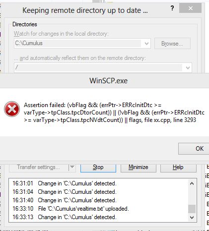

It failed with a "Invalid Pointer Operation" this time, although again WinSCP doesn't fail just the KRDUTD function, which can't be restarted because although it recognizes the change to directory it won't do the FTP any more so winSCP has to be restarted.

The problem seems to be random although I have never had it happen while at the system, it is always after it has been running for some time when my win id is locked, no one else is using the system and typically, apart from WinSCP, only my weather software running (invariably during the night, unfortunately). I don't remember if the first occurrence was the same but the last three have been "Invalid Pointer Operation" and the error box appears twice. On removing the error box, I can restart the krdutd function and it detects that the file has changed but it doesn't FTP it. I have to exit WinSCP and restart it.

Latest failure, instead of 2 x Invalid Pointer Operation, got one of those with a...
Access violation at address 74F21EF3 in module "KERNELBASE.dll" Read of address 03550000
...over the top

Having received debug version, run it with problem occurring and having sent debug output...
Have again had problem with Invalid Pointer Operation messages plus never ending...
Assertion failed:FTerminal-> OnReadDirectory==DoReadDirectory, file Components\UnixDirView.cpp,line573
...messages.
Have sent you email with location of new debug log file.
