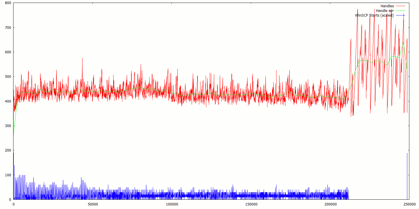

I have also experienced this issue and have been working on gathering more data before reporting it.
It looks like Error code 3 is caused when the "abort()" function is called in windows, this may not be in WinSCP, since it can happen in lowel level system libraries, but it's at least something extra.
Once this issue began I started reading up on possible causes. The symptoms are the same for me, so I started recording as much information as I could to a csv file every minute. Right now it records program run time, memory use, open handles, and how many times winscp has been called.
Interestingly enough we made it through more than 10,000 runs of winscp this time before the issue happened, but on previous attempts it lasted only a day (probably around 1,000 runs or so).
Interestingly enough when this issue happened the handle activity became highly erratic, nominal usage for my program was around 430 handles, once this issue came up the server suddenly started using as many as 800 handles. Interestingly enough, this persisted for several hours even though I stopped calling winscp.
This may, perhaps, indicate that the issue is instead in the .net layer and not winscp itself (which is my assumption anyway, winscp seems to be failing to open it's i/o channels).
Included is the graph showing handle usage and the csv file it was generated from. I would be more than happy to help debug this issue in any way that I can.
Description: Graph showing winscp starts vs handles used on the system.
Description: Recording of various program stats, taken at minute intervals for the entire runtime.
@mjfirm: Thanks for sharing this. I've too found that WinSCP process exits in low level libraries, well before any actually WinSCP code runs.
What does your handle counter actually counts? Handles of WinSCP only? How does it count them?

I couldn't find a way to measure WinSCP's usage, but originally I was afraid I had a handle leak, as the version of windows we use has a hard limit on the number of handles a process can have. We're not even approaching the 10,000 handle limit, but it seems like this activity is telling.
I'm measuring the "current" process from .NET using:
Process p = Process.GetCurrentProcess();
...p.HandleCount...
At the point where this happens WinSCP is no longer able to run for any length of time, so I didn't think to try to capture data from the WinSCP processes. I'm not sure that I could very well, unless the .NET library allows access to the process info.
The one thing I haven't tested yet that was on my list was if WinSCP can be started interactively once this has happened. I know that even restarting the service won't fix the problem, being able to run it by hand will help to indicate if this is some sort of system wide issue or if it's actually the service manager in windows causing a "leak" of some sort.
If you can think of any other data that I can track, I'm more than happy to try it out.
Oh, one other note, it seems to happen at irregular intervals. It took nearly two weeks once, and only one day in another instance. It usually takes about a week however.

Interesting Developments
My service finally ran into this same problem again. This time after running WinSCP 26,423 times. (those last couple of times may have been failures). It took it 1,034,200.985 seconds, or just under 12 days.
I ran my additional tests this time, running WinSCP manually as another user, and as the account that my service was running as passed, WinSCP itself started just fine (this wasn't too surprising). I also tried running my service manually, I added a bit of code to it long ago that detects if you're running the program interactively and if so, creates a console and fakes running as a service so you can see the debugging output. It ran perfectly as both users.
This means that the problem only exhibits itself when run as a service, or perhaps when run for long periods under a supervisor program of some sort. It looks like the issue does have something to do with the fact that it was running as a service. Potentially a buildup or leak that is never being cleaned up by the OS because of the way the service manager works in windows?
The results of my program stats recorder shows the same sudden spike in handle usage the moment we experience the first failure, the average handles open at a given moment spikes to more than double what it was to nearly 800 (with spikes nearly to 900).

Each .wsf script running connects around 4-5 times to the same site pulling different files. There are 5 of these all running, which can create 20+ connections to the same FTP site in close proximity to one another.
I believe by running these scripts simultaneously I can reproduce this fairly close to on-demand. I have this installed in a test environment right now, please let me know if there's any more debug I can provide. I've attached the debug from a failed run with session.debuglogpath set.
Re: what does it mean exit code 3?
@drbergeron: Thanks for your report.
I read all the new and old reports over and over again. I seems the problem is occurring on Windows 2008 (R2 SP1) only (though for some reports where I know Windows version number 6.1.7601, it can also be Windows 7 SP1).
That may explain why I was not able to reproduce the problem on my Windows 8 test machine, where I have a task scheduled every minute for over 4 months without a single problem. I have tried now to intensify the test by running multiple sessions in parallel as @iverchenko suggested.
Can others test suggestion by @agriffin (post here) to set process to run in 2003 compatibility mode?
@agriffin: Yes, you are probably correct that this issue exist for any kind of frequent use of WinSCP. It just seems to be more common with .NET. Though it can just be a coincidence.
I was finally able to reproduce this myself (after 100 000 runs). I'm going to debug this soon.
