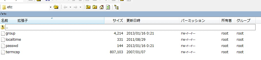

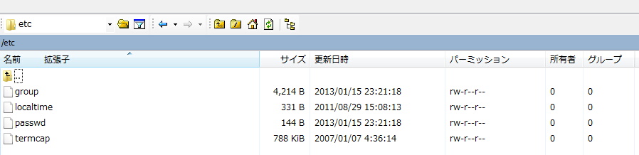

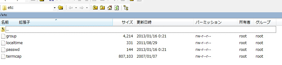

The screen capture of GUI is attached.
Although the same directory is displayed by WinSCP ver.5.1.3 and ver.4.3.7, time stamps differ for 1 hour.
I think that ver.4.3.7 is right.
This screen capture is the same as the directory displayed by Debug 1-level log file attached last time.
Thank you for your consideration.

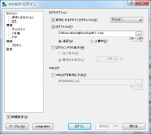

I set up the level of the log file like an attached image.
But you said "It does not look like a Debug 1-level log".
How should I do?
Thanks.

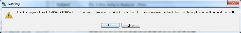

However, the warning of the attached file is displayed.
I expect that it will be early exhibited by the newest Japanese version of WinSCP. :wink:
Description: warning
