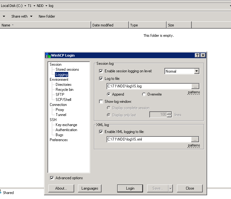

logging window screenshot attatched
Description: log

I'm (now) using the .com that is in the same folder as the exe. The version of the exe is 5.1.1 build 2735.
I can't see a way to determine the version of the .com but as it's in the same install folder I assume it's the latest.
