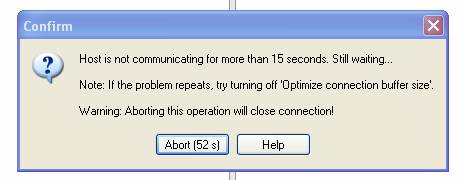

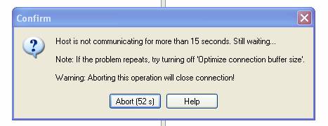

I have tried your debug version. I didn't have access to drive C, so I must create environment variable WINSCPTRACE.
The problem is if I didn't create the trace file, the transfer always returned an error (see attachment).
But, if I create the trace file using environment variable, the transfer just working fine.
So, the trace file didn't record any error.
Do you know what is the cause of the problem?
FYI, I also got the same error transfer when using WINSCP 5.1 (non debug version).
