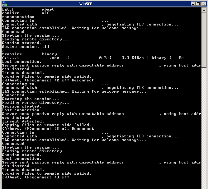

Hello everyone,
I'm also having a similar issue. With version 5.5.3:4214 I'm seeing that no matter if I have "abort" or "continue" or anything else, it will always try to reconnect. I've used "option reconnecttime 1" as an interval, because I want it to abort.
It does, indeed, try forever. My log file was about 6GB. :)
Is there another way to "on error abort"? I do not wish for it to try to reconnect at all... the scheduler will try to rerun the batch at a later time anyway.
Attached, I have a screenshot of my batch file run manually. If I punch in an "A" at the right moment, it will abort and exit. If not, it will continue running into perpetuity... or until the network connection gets fixed.
Thanks!
Aaron
Description: Screenshot of reconnection
