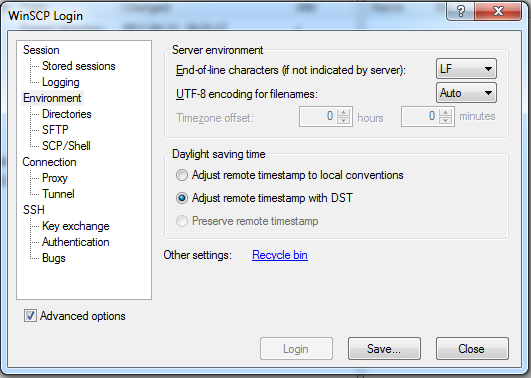

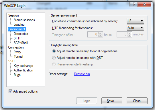

  1. What DST setting are you using in the GUI?

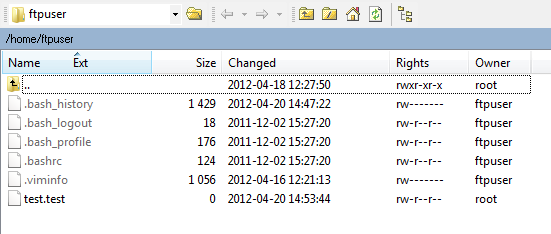

  2. Please post a screenshot of GUI with some test directory as evidence of correct timestamps

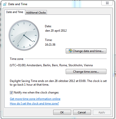

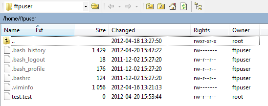

Description: Client time+timezone
Description: Settings try 1
Description: Results try 1
