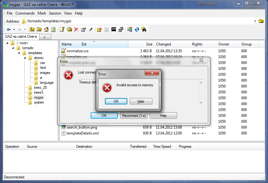

I have Win7 x64 and not very high-speed Internet connection (3G).
And I receive "Invalid access to memory" error message very often (about 5 min interval or something). After I click OK the program entirely freezes and it is necessary to kill the process. It is very hard to work in such way: I need to kill the program and run it again, and edit my files again because previous changes were not uploaded to a server.
WinSCP version: 5.0.6
Previous version (4.x) freezed also very often (without showing this error). And even not on 3G, but also when I used usual Internet (may be not very high-speed, but good enough).
And the program asks me very often: Lost conection. Reconnect? Lost conection. Reconnect? Lost conection. Reconnect?
It is FTP client and patience trainer in one :)
Thank you for this program. I do not know better FTP/SFTP/SCP client. I hope it will be more and more stable, clear and smooth. Good luck!
YuryPlashenkov
Found that this error occurs when I save the file just edited. Then I switch to WinSCP to see the progress of upload and I see the picture which I attached in first post. I.e. the "Invalid access to memory" error message and the reconnection window under it. The button in reconnection window counts: 3, 2, 1... and when it reaches 1, nothing happened, it stops on this 1. Then I click "OK" in the error message dialog box, then WinSCP entirely freezes, and I have to restart it.
