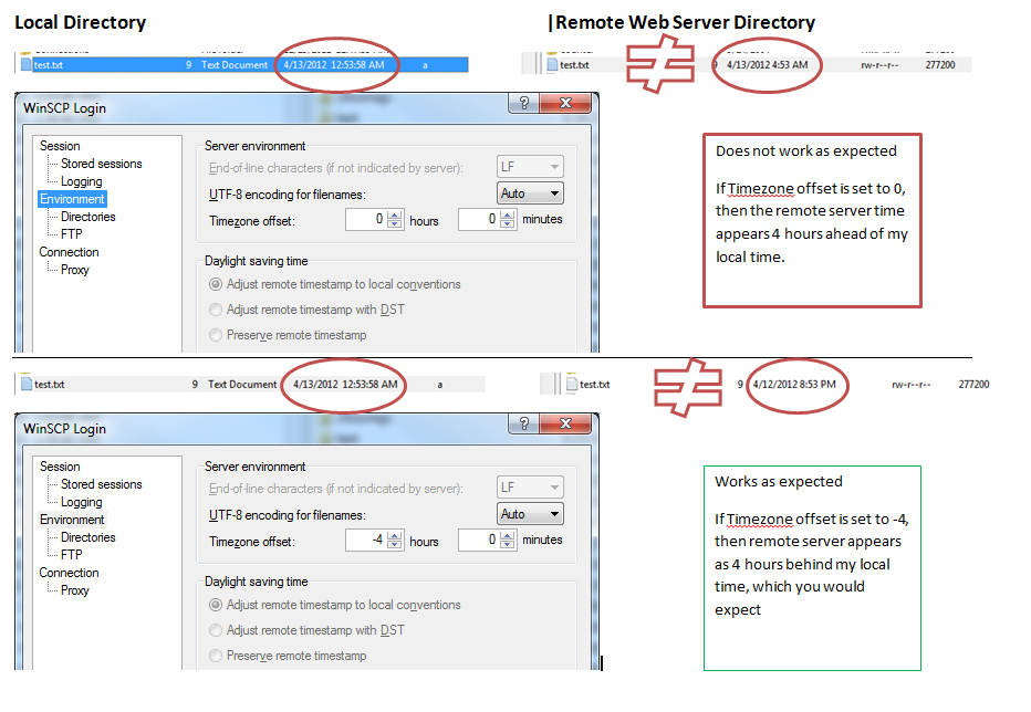

The following is causing serious problems for FTP synchronization.
When using WinSCP to view standard FTP access of an Ipower hosting site, the uploaded times on the remote server are exactly 4 hours ahead of my local time. This means that a file I upload at 6 pm will show a 10 pm remote time. This may or may not be related, but GMT time is 4 hours ahead of my local time. The problem does not appear to occur when using FileZilla (I prefer WinSCP). Also, when I use the time zone offset, it offsets the remote server time using my current time (i.e. if my local time is 6 pm, it will show 2 pm when I use the WinSCP Timezone offset of -4 hours)
Timezone offset summary:
If Timezone offset is set to 0, then the remote server time is displayed 4 hours ahead of my local time.
If Timezone offset is set to -4, then remote server time is displayed as 4 hours behind my time.
If timezone offset is set to +4, then the remote serve time is displayed 4 hours ahead of my local time.
This is causing serious problems for synchronization.

User999999 wrote:
Prikryl, I'd be happy to include more info. What is it you would like to see? (i.e. screenshots, typing out examples, etc.)
As much as you can. Screenshots with some comments would be nice. Thanks.
Please review the attached PNG file.
Note the difference in time between Local Directory and Remote Web Directory, despite timezone settings.
The upper scenario in the picture demonstrates my problem.
The lower scenario demonstrates my attempt to resolve the problem.
For curiosity sake, I tried a Timezone offset of +4, which produced: Local time:12:53 PM; Remote Time: 4:53 PM --> Thus a +4 timezone offset did NOT affect my time-stamp difference problem.
Suggestive feedback would be greatly appreciated.
Description: Note the difference in time between Local Directory and Remote Web Directory, despite timezone settings
