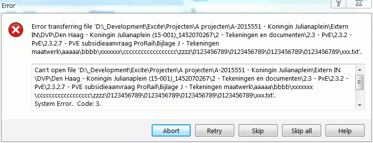

XXL path problem
Case description.
Local: Win 7 File System; with some XXL pathname
Remote Backup: Linux ftp server (more than 1 tested; same result)
Action: Interactive winscp sync to remote
Version: 5.9 (build 6786)
Error:
Attached
winscp builds the complete XXL directory path on the Remote Backup.
Determines that a file has to be transferred from the source.
Ok till here. But afterwards....
Solution suggestion.
Maybe that when opening the file the \\? prefix before the pathname
is not used.
Ref:
https://learn.microsoft.com/en-us/windows/win32/api/fileapi/nf-fileapi-createfilew
43,049
Re: XXL path problem
hanh@... wrote:
Case description.
Error:
Attached
is not used.
Ref:
Thanks for your post.
This issue is being tracked already:
https://winscp.net/tracker/1337
