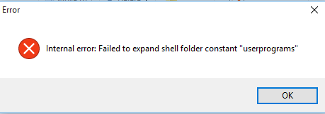

Failed to expand shell folder constant “userprograms” - “SHGetFolderPath failed with code 0x80070002
I get the following error on Windows 10 when installing via the system account or SCCM "Failed to expand shell folder constant “userprograms” - “SHGetFolderPath failed with code 0x80070002"
This error only happens when installing with the System account or SCCM the first 2 times on Windows 10. If install with just the administrators account it doesn’t happen at all. In addition,
SHGetFolderPath has been a deprecated function since Windows Vista.

2016-02-03 15:05:17.878 Warning: SHGetFolderPath failed with code 0x80070002 on folder 0x8002
2016-02-03 15:05:17.878 Exception message:
2016-02-03 15:05:17.878 Message box (OK):
Internal error: Failed to expand shell folder constant "userprograms"

Re: Failed to expand shell folder constant “userprograms” - “SHGetFolderPath failed with code 0x80070002
Can you send me an email, so I can send you back a development version of WinSCP for testing? Please include link back to this topic in your email. Also note in this topic that you have sent the email. Thanks.
