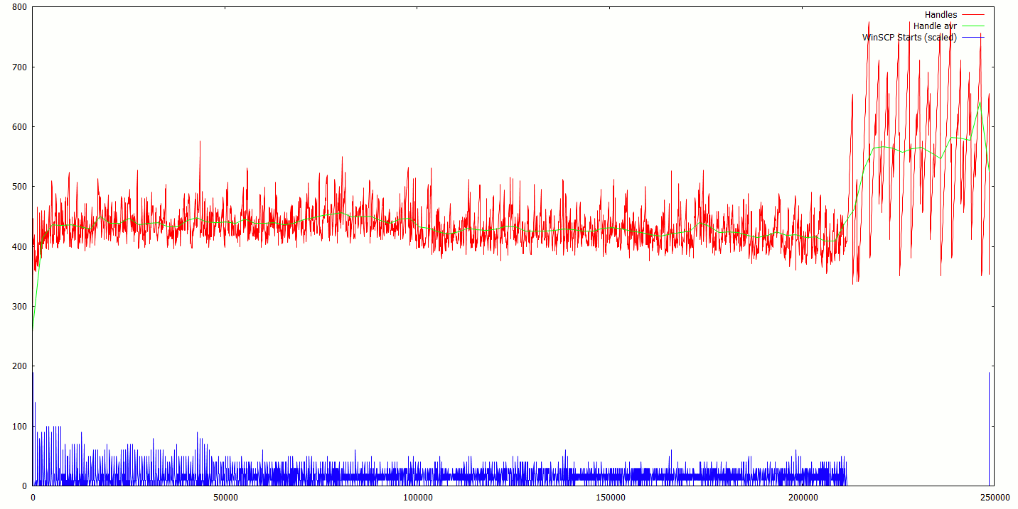

I have also experienced this issue and have been working on gathering more data before reporting it.
It looks like Error code 3 is caused when the "abort()" function is called in windows, this may not be in WinSCP, since it can happen in lowel level system libraries, but it's at least something extra.
Once this issue began I started reading up on possible causes. The symptoms are the same for me, so I started recording as much information as I could to a csv file every minute. Right now it records program run time, memory use, open handles, and how many times winscp has been called.
Interestingly enough we made it through more than 10,000 runs of winscp this time before the issue happened, but on previous attempts it lasted only a day (probably around 1,000 runs or so).
Interestingly enough when this issue happened the handle activity became highly erratic, nominal usage for my program was around 430 handles, once this issue came up the server suddenly started using as many as 800 handles. Interestingly enough, this persisted for several hours even though I stopped calling winscp.
This may, perhaps, indicate that the issue is instead in the .net layer and not winscp itself (which is my assumption anyway, winscp seems to be failing to open it's i/o channels).
Included is the graph showing handle usage and the csv file it was generated from. I would be more than happy to help debug this issue in any way that I can.
Description: Graph showing winscp starts vs handles used on the system.
Description: Recording of various program stats, taken at minute intervals for the entire runtime.
@mjfirm: Thanks for sharing this. I've too found that WinSCP process exits in low level libraries, well before any actually WinSCP code runs.
What does your handle counter actually counts? Handles of WinSCP only? How does it count them?

I couldn't find a way to measure WinSCP's usage, but originally I was afraid I had a handle leak, as the version of windows we use has a hard limit on the number of handles a process can have. We're not even approaching the 10,000 handle limit, but it seems like this activity is telling.
I'm measuring the "current" process from .NET using:
Process p = Process.GetCurrentProcess();
...p.HandleCount...
At the point where this happens WinSCP is no longer able to run for any length of time, so I didn't think to try to capture data from the WinSCP processes. I'm not sure that I could very well, unless the .NET library allows access to the process info.
The one thing I haven't tested yet that was on my list was if WinSCP can be started interactively once this has happened. I know that even restarting the service won't fix the problem, being able to run it by hand will help to indicate if this is some sort of system wide issue or if it's actually the service manager in windows causing a "leak" of some sort.
If you can think of any other data that I can track, I'm more than happy to try it out.
Oh, one other note, it seems to happen at irregular intervals. It took nearly two weeks once, and only one day in another instance. It usually takes about a week however.
So you have one continuously running .NET process/service that references winscp.dll and regularly opens and closes WinSCP.Session, is that correct? And that .NET process seems keep increasing its allocated handles. But once the problem occurs, restarting that .NET process does not help. Do I understand right?
mjfirm
12
Denver, CO
Very close. The service would run forever, except we have to reboot when this issue happens.
There is one very long running .NET service that spawns thousands of WinSCP processes via the WinSCP .NET assembly, it does this on a schedule, we have maybe 35-40 different servers that it connects to. It makes a connection about every 10 minutes (depending on host).
At first I thought the issue may be with handles not being cleaned up correctly, but as the graph shows, the handles in my process are being cleaned up, so that isn't the issue. However, when the issue that we're discussing happens the WinSCP assembly throws a unique error. I've added an extra handler in my program that actually stops the main thread when this exception is caught, so I stopped trying to run WinSCP after the first error.
At that point, after WinSCP got that error, and my main thread has stopped (which prevents the program from running WinSCP anymore) then we see very erratic behaviour in the number of used handles, almost like something persistent in the WinSCP .NET assembly is still trying to recover and/or run a WinSCP process.
When this happens stopping and restarting the service does not help the situation. I have actually stopped the service, made sure the process wasn't running at all anymore, and then restarted it only to get the same error again.
There are a couple of tests I intend to perform the next time this happens to isolate the situation further. It seems like when this happens the program is always running as a service, my program has the ability to also run as a console program, so I will try running it interactively outside of the windows service manager, which may help the situation. I am also curious if this is only affecting .NET programs trying to run WinSCP or if WinSCP itself will have trouble starting. My guess is that WinSCP will start just fine if run interactively once this happens, but I will try it myself the next time it happens and I will let you know.
I hope that helped. I'm happy to elaborate on any aspect of the program or process here.

Each .wsf script running connects around 4-5 times to the same site pulling different files. There are 5 of these all running, which can create 20+ connections to the same FTP site in close proximity to one another.
I believe by running these scripts simultaneously I can reproduce this fairly close to on-demand. I have this installed in a test environment right now, please let me know if there's any more debug I can provide. I've attached the debug from a failed run with session.debuglogpath set.
42,990
Re: what does it mean exit code 3?
@drbergeron: Thanks for your report.
I read all the new and old reports over and over again. I seems the problem is occurring on Windows 2008 (R2 SP1) only (though for some reports where I know Windows version number 6.1.7601, it can also be Windows 7 SP1).
That may explain why I was not able to reproduce the problem on my Windows 8 test machine, where I have a task scheduled every minute for over 4 months without a single problem. I have tried now to intensify the test by running multiple sessions in parallel as @iverchenko suggested.
Can others test suggestion by @agriffin (post here) to set process to run in 2003 compatibility mode?
agriffin
7
Per the above – it did run fine for a couple weeks while set to 2003SP1 compatibility mode, but eventually we ran into the same behavior again.
agriffin
7
The application is just a Perl script that does a command line call to winscp, run through visual cron. Since I get the same behavior from the Windows Task scheduler when it happens, I think that rules out the visual cron aspect, and since it runs reliably in userspace even when ii won't run as a task, I think perl is probably safe (perl is also being used to run other tasks that do not stop when we run into this problem. For giggles I used PowerShell to replicate what the perl script did and ran into the same problem, as well as just using a plain old batch file)
agriffin
7
Sorry, I guess I didn't make it clear. As far as I can tell any automation of this eventually causes problems. I'm not using any .net assemblies here, just command line. I saw from running through the related threads, however, that whether or not someone is using the assemblies, once the problem crops up, winscp doesn't work in *any* automated context, command line or assemblies. I *do* get exit code three from any automated process that calls it after that. To be clear, in Windows Scheduler this is "path not found" and is a result of WinSCP failing to build an FTP session. I have been presuming this is the same for others as well, since WinSCP does not have an exit code three itself.
@agriffin: Yes, you are probably correct that this issue exist for any kind of frequent use of WinSCP. It just seems to be more common with .NET. Though it can just be a coincidence.
I was finally able to reproduce this myself (after 100 000 runs). I'm going to debug this soon.
Wompus
I've also run into this issue (Windows Server 2008 R2, scheduled file transfers every 5/10 minutes).
Also had a consistent connection failed error because the server was offline.
Also have a very regular process combined with irregular connection fails.
Tried the 2003 compatibility, did not work.
Very similar situation to mjfirm.
