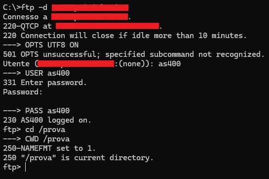

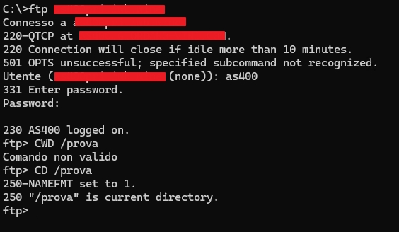

Hi Martin,
if I try the command "cd /prova" it goes to the correct folder.

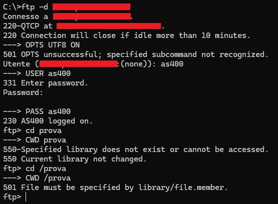

But if I run "cd prova" (without the slash), I get an error. If I subsequently run "cd /prova" (which previously worked), I get a second error.
From now on any "cd" you play will not work.
