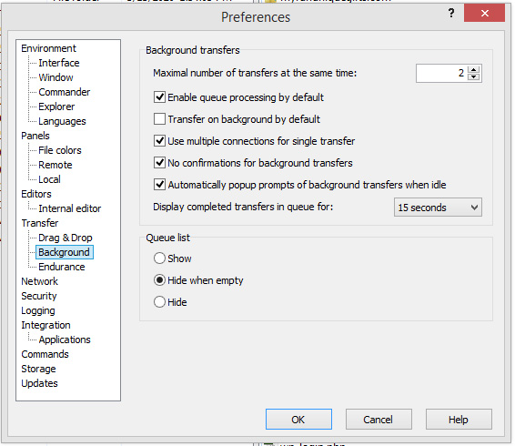

glenhall
4
uk
i always noticed this with winscp, when i compare downloading something with filezilla or the old flashFXP client, winSCP always seemed slower as if it was capped, so im glad i found this subject here, but when i go into my site manager/advanced, i can see the optimize option but its greyed out and i cant untick it.
i have a passive option with can be ticked/unticked
42,725
The option is not available/relevant to FTP protocol.
