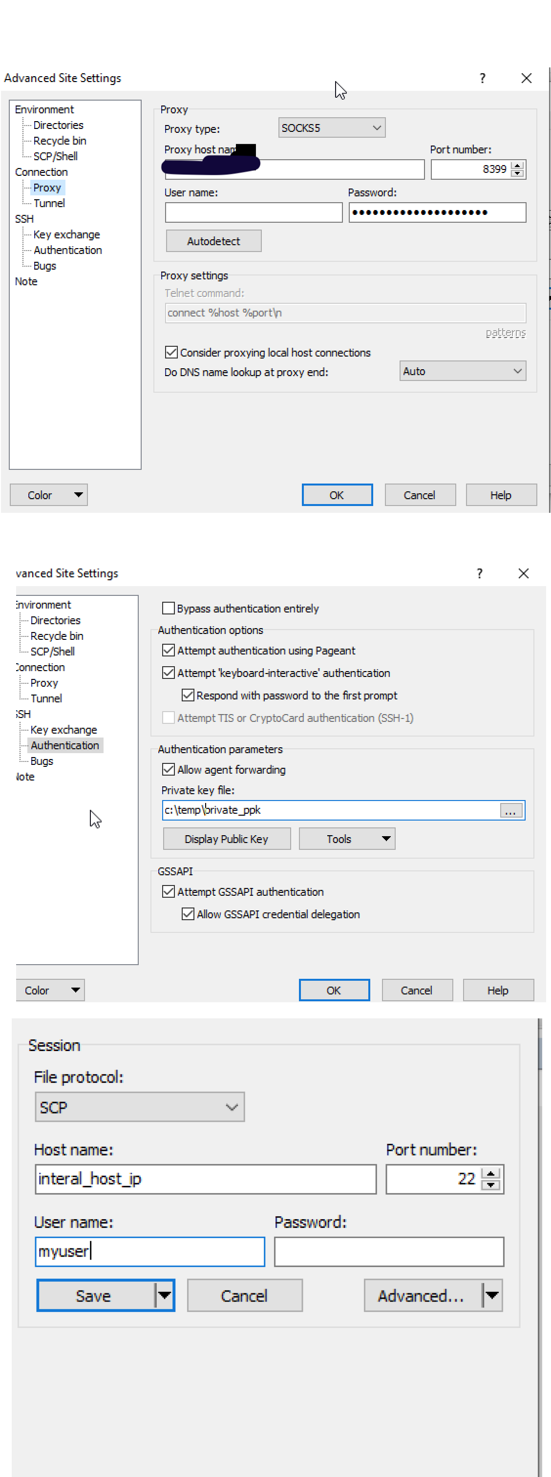

Hello, I have winscp 5.17 and I am trying to get it to proxy to a socks 5 host and then connect to another host using ssh public key authentication.
I get the error
2020-05-05-28 09:12:32.704 Waiting for data timed out, asking user what to do.
2020-05-28 09:12:32.704 Asking user:
2020-05-28 09:12:32.704 **Host is not communicating for 15 seconds.
I think I have set up the proxy information and scp information correctly in winscp? I have added the ssh private key to the proxy authentication area. I have tested the basic socks 5 connection with a mobile shadowsocks application and am able to login successfully.
The shadowsocks socks5 server encryption method I'm using is chacha20-ietf-poly1305. Does winscp support this?
Here is the related logs.
external_host is the ip address of the socks5 server I am trying to connect to. internal_host is the ip address of the host I want to proxy to after connecting to the socks5 server. Thanks.

Here is the basic configuration of shadowsocks I'm following which has the method field where a user can specify the encryption they would like.
https://www.linode.com/docs/guides/create-a-socks5-proxy-server-with-shadowsocks-on-ubuntu-and-centos7/
Here is my shadowsocks configuration file.
    "server":"0.0.0.0",
    "server_port": 8399,
    "password":"thepassword",
    "timeout": 300,
    "method": "chacha20-ietf-poly1305",
    "fast_open": true
By ssh private key I mean the putty private key file.
I've attached a file with screenshots of my winscp setup.
I hope that it is possible to use winscp in this manner.
Client copying a file -> socks5server -> destination server receiving copied file(s)
Thanks!
