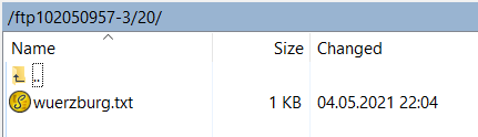

But connecting to this server with the WinSCP-GUI version I see this directory /ftp102050957-3/20 as the screenshot 29-05-_2021_17-44-16.png (below) shows.

Description: Screenshot showing the path which cannot be found.
