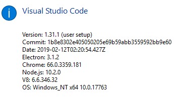

Do you have 32-bit or 64-bit installation of VSCode?

That's weird. People over at vscode say it might be a broken installation, but I reinstalled it already. =/
I'm using the 64-bit version.
