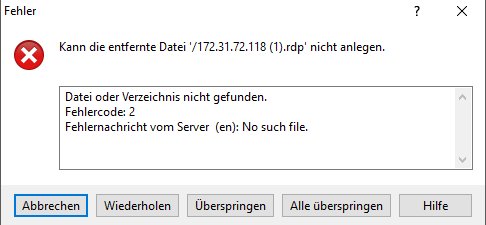

if I want to upload a file that is smaller than 100 KB to an SFTP server, I get the following error message. (see attached file)
Larger files are working fine.
With FileZilla I can transfer the smaller files to the server.
I'm using WinSCP 5.15.1 (Build 9407)
Windows Version 1803 (Build 17134.112)
SFTP
I'm using the GUI

Unfortunately, nothing is written to the logfile if I want to upload a file that is smaller than 101 KB. I have already increased the debug level to 2.
Re: Files < 100 KB cannot be uploaded to a sftp server
It's not possible. Please post the log anyway along with a matching error message.
Frank IJskes
Files <100kB are not transferred
Most likely it is because the setting "Enable transfer resume/transfer to temporary filename" is set to "Files above: 100KB". In this interface set this to "All files"
In scripts use:
put -resumesupport=on * ........
Re: Files <100kB are not transferred
@FrankIJskes: OK, but that would not explain why it works in FileZilla, as that behavior is actually different to what FileZilla does.
