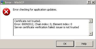

Update Certificate error

Re: Update Certificate error
Thanks for your report. We have switched to Let's Encrypt recently.
What version of Windows are you using?
henry3
26
It is on a XPSP3 Machine
We have deployed a new certificate. Can you please try again? Any feedback is appreciated.
henry3
26
The new certificate worked on XPSP3 and allowed the update to 5.13.4.
