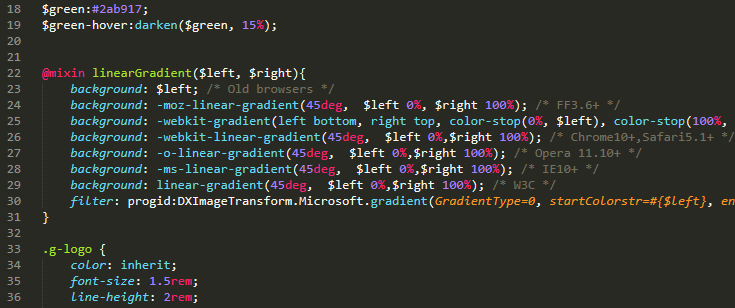

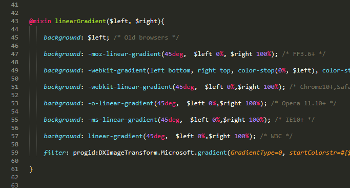

I tried to edit a scss file both with the internal editor and sublime text 3 editor, in both cases extra lines are being added to the file (1 extra empty line for each line).
The same file opened form edit in filezilla is fine (no extra lines added).

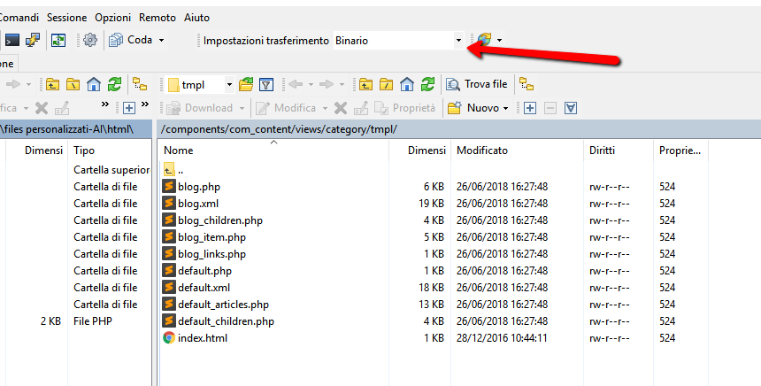

Try forcing binary transfer mode (works with external editors only).
I tried "binary mode" + sublime text 3 as editor
but I still got the extra lines
42,288
Re: Editing a scss file add extra lines in the file
42,288
What did you do to force the binary mode?
I can still see that text/ascii mode is being used:
. 2018-08-07 13:17:28.363 Ascii transfer mode selected.
