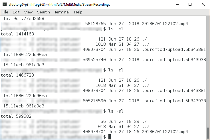

Thank you for the quick response. I have attached a complete log for which only a portion of the file was transferred to the server after almost an hour and a half of trying. Also attached is a screen shot of a terminal window showing a directory listing on the server. In that terminal window, I began entering periodic 'ls -al' commands about an hour after the FTP transfer started. Thanks for your help!
Re: Automatically resuming from where transfer stopped
OK, so it looks like your FTP server does save ongoing transfers to a temporary file name (.pureftpd-upload...). And sometimes, when a connection is lost, it won't rename the file. Or it takes some time before it renames the file. So when WinSCP reconnects, it sometimes won't find a partial file and starts over. I'm not sure there's anything WinSCP can do better. Maybe FileZilla was just lucky.
