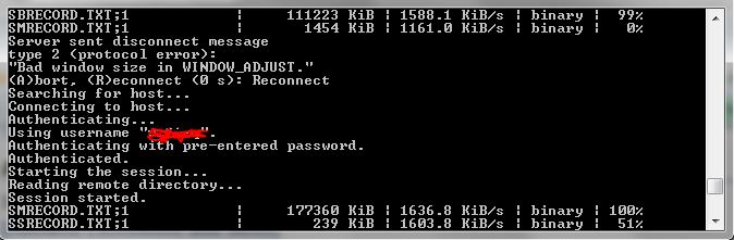

Hi.
I am using command line to synchronise files. I have only been using for a few weeks which have been fine fine but now I have 2 problems which are related.
This is with SFTP, using version 4.3.7.0
1. I get an error message "Bad window size in WINDOW_ADJUST". I do not know why I get this message and cannot find anything to help me explain. This by itself is not a big problem (but it would be nice to understand and fix it) because WINSCP reconnects automatically and tries to continue.
2. This is the bigger problem. If I get the above error, WinSCP reconnects and carries on - BUT it redownloads the entire file into the existing partfile at the end of the data which is already there. Surely, the whole point of resuming is not to replicate the data? So I end up with a file which contains 2 copies of all the data prior to disconnection (in this example below the first 1.5MB or so) and one copy of the rest of the file. I also get no notification that this has happened except in the CMD window. Is there a fix for this or is there something I can change on the command line or in the txt file to make this problem go away without having to use ini file? I have tried to read all the relevant documentation but cannot find answer to this.
The command I use is
winscp.com /open %user%:%pass%@%server% -hostkey=%serverhostkey% /script=Weeklydataall.txt
and the contents of weeklydataall.txt is
option batch on
option confirm off
cd quiz
option include *.TXT*
synchronize local
exit
Thanks very much.

Hi
I have some more information on this but it does not answer why the resume does not happen properly. It appears that the connection is interrupted when 1GB in total has been transferred per session. When 1 GB is reached, the transfer is interrupted, then WinSCP reconnects and starts the interrupted file again copying down into the existing partfile but appends the entire file to the existing partfile as previously described.
The disconnect and reconnect would be fine if the resume worked properly but it does appear that it does not.
Any ideas please?
42,398
Re: interrupted transfers not resuming correctly
Any ideas please?
Please email me a full log file showing the problem.
LS
Email sent
> Hi Martin
> Ref topic
> https://winscp.net/forum/viewtopic.php?t=2406
> It does appear I have 2 problems still -
> 1) Cannot force the script to Abort. This one is set to Abort and also
> reconnecttime off. I tried various options with no luck with any of them.
> 2) Resume logic does not seem to be working properly.
> here is a log file showing the problem and also screen print of the file
> after the data has been finished. I highlighted the first field of the
> second attempt. As you can see it is appended to the failed part.
> I hope this helps in finding a solution.
> Thanks for all your work.
Email has the attachments.
LS
workround
And just in case anyone else has same problem. -
To get round this problem, the solution I am using now is to use the ini file pre-copied into the same folder as winscp.exe and winscp.com with ResumeReport=2 already set to prevent the partfiles being created. Therefore the connection is still resumed but the file is started again cleanly. It works for us so far in testing. :)
