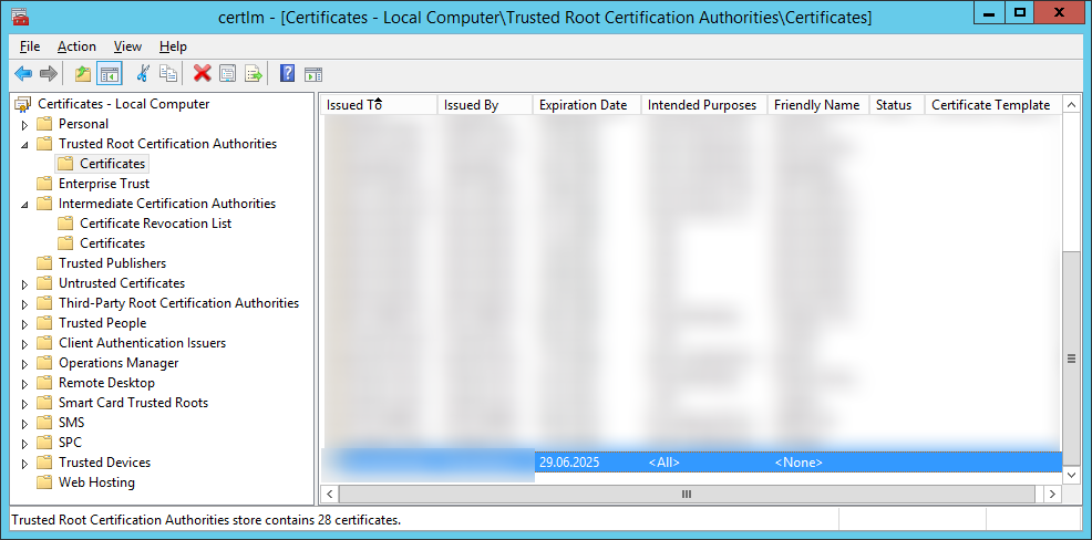

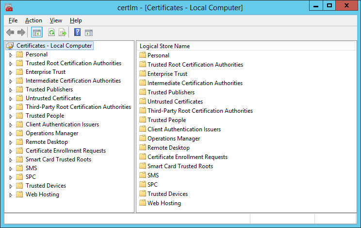

@martin,
if I will add my own ROOT certificate (my own CA by which my self-signed certificate was signed) to Windows certificate store, then it will work?!
I wasn't able to do so.
I added my own Root CA and SubCA to Windows storage (see screenshots):
Certificates - Local Computer
- Trusted Root Certification Authorities - Certificates
- Intermediate Certification Authorities - Certificates
Then I remove -certificate="*" from command line which is run from /script=Script.txt
Tried to connect to the Server which has certificate which was signed by my own CA.
And got error - see log attached (private).

I have to add remote server's certificate to Windows storage also? Then to which part of the storage?
Thank you!

43,040
Re: Verifying the Host Certificate in Script with CA certificate
Makc666 wrote:
In which part of the Store then I have to put them?
Where WinSCP is looking for those certificates then – in Global storage, Users storage, or may be in some other?
There's the CertVerifyCertificateChainPolicy(CERT_CHAIN_POLICY_SSL, ...) API that WinSCP uses:
https://learn.microsoft.com/en-us/windows/win32/api/wincrypt/nf-wincrypt-certverifycertificatechainpolicy
So WinSCP does not look anywhere specifically. It's all up to the above API.
@martin: This API killed my mind today.
Yes, I can see WinSCP uses somehow the Windows Certificates Store.
If you don't have you third-party Root-CA and Sub-CA in Windows store you will get this error in WinSCP logs:
. 2017-02-06 15:38:00.824 Certificate failed to verify against Windows certificate store: Error: 800B0109, Chain index: 0, Element index: -1
When you add your Root-CA and Sub-CA in Windows store you will get this error in WinSCP logs:
. 2017-02-06 17:02:40.025 Certificate failed to verify against Windows certificate store: Error: 80092013, Chain index: 0, Element index: 0
For now I am not able to solve this problem.
The only thing I can tell that using
certutil -setreg ca\CRLFlags +CRLF_REVCHECK_IGNORE_OFFLINE
is not our case as it is only for your own CA you have at your server.
But for 3-rd party Root-CA and Sub-CA certificates this is a problem.
I understand that WinSCP sees the certificates but WinSCP can't do something.
And this something is not clearly for me.
As I have told that when I use cacert.pem it works perfectly.
I need help?! :)

- Root certificate in "Trusted Root Certification Authorities" (I call it CA-ROOT);
- Intermediate certificate in "Intermediate Certification Authorities" (I call it CA-SUB) (SUB is from subordinate).
1. Error:
@sessionlog@
Add into Windows Storage "certlm - [Certificates - Local computer]" (see screenshot) certificates of your custom CA:
- Root certificate in "Trusted Root Certification Authorities";
- Intermediate certificate in "Intermediate Certification Authorities".
(Start - Run/Search - certlm.msc)
