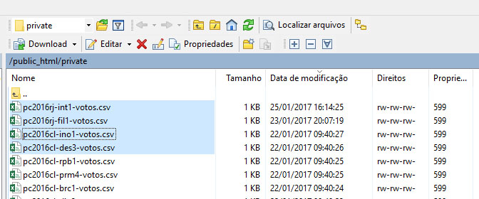

I've done a print screen to exemplify. As you can see from the dotted square, the third file is the one selected.
That's why I've selected the four files starting from the first one and then pressing the shift-down arrow. But, let's say I wanted to download only the first three files. In any other Windows app, to do so you just unselect the fourth file and get back to the third by pressing shift-up arrow.
As you can see, that really moved the dotted square back to the third file, but the fourth remained with the blue background, indicating that the fourth file was not unselected.

The dotted rectangle responds to the arrows, moving up and down accordingly. The problem is the blue background. This is what happens: whenever the filename background turns to blue -- meaning the file is selected -- you can't just reverse it with the shift-arrows, only by ctrl-clicking on it.
Again, that's by design. Focus is independent of selection and vice versa. If you do not like it, switch to Explorer-style selection as per my previous post.
