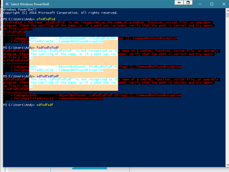

Ah ok - I just assumed any terminal would work (I have Cygwin installed, and I can access ssh using `ssh xxxx` via the command line, so I just assumed it would work). Shame, as Powershell has a much nicer interface to Putty (and I like the way you can grab specific parts of the terminal window, not just the whole lines)

Use Alt+drag.
The PowerShell does formatting because it understands the commands, because they PowerShell commands. It wouldn't be able to magically format remote/shell commands, because it won't understand them.

Ahhh I didn't realise you could do Alt+drag in PuTTy. The main reason I want this, for example, is when I have the output of a list of files. I just want to be able to grab one of the columns. Currently I have to copy the lot, then paste into an editor, then trim off the extra stuff I don't want. The syntax highlighting I can deal without - would have just been nice :)
