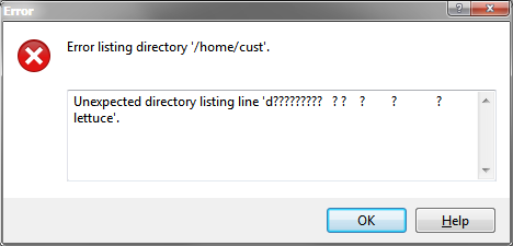

Hello, WinSCP displays a message (attached) because one of the items is actually a link to a SSHFS that's it links to files located on a remote server, and I (cust) do not have rights to see the link's attributes. If I see it in PuTTY, I see this:
ls -la
ls: cannot access lettuce: Permission denied
total 216
drwxrwsr-x 4 cust cust 4096 Jul 30 16:19 ks
d????????? ? ? ? ? ? lettuce
drwxr-sr-x 2 root cust 4096 Jul 8 20:05 logs
But at least I can see all files in the directory. With WinSCP, I only see files before the link. WinSCP can't parse question marks and then it stops parsing, while it should continue.

Thanks for your report. What protocol? SFTP or SCP?

All I can say is now it does show the problem items correctly (with question marks, see attacment). Unfortunately, there are no other items in the directory nor can I create so I can't test if WinSCP properly shows items after these, but I think it does. Thank you.
