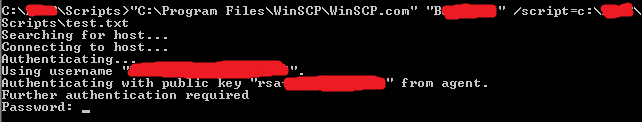

For this second site, we store the private key in Pageant and that authenticates fine. After that step, it asks for a second password while displaying the message "Further authentication required" (as per attachment 1.png). If I type the password into the GUI it works fine. The second password is a requirement of the people we are connecting to.
For the purpose of this connection, we need to script it to schedule it to run every 90 mins, 24 hours a day. My script currently looks like this:
The command line:
"C:\Program Files\WinSCP\WinSCP.com" "<SITE NAME>" /script=c:\<SITE NAME>\Scripts\test.txt

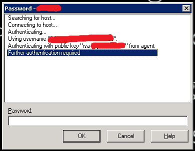

When I run this, I get the message in attachment 2.png. Again, if I type in this password it connects.
However, since there is a requirement to automate it (as we don't currently work 24 hours a day) I'm looking for a way to pass the second password through as part of the script (I know the password will be shown in clear text in the script file). I've had a look in the scripting guides and can't see anything (I don't read C# so I can't tell if it's possible in .NET Assembly or not).

Have you tried saving the password in the stored session you are opening?

Hi
That worked - thanks very much!
I didn't think to try that as I thought it would overrule the private key and try to authenticate by password.
I'll take a look at the 'open' command and adjust my script as appropriate.
