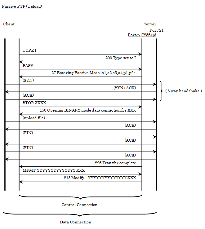

As I mentioned in the previous post, I think that a possibility that packet size is the cause is low.
Before the connection initiation (three-way handshaking) of a data connection is completed, isn't the STOR command transmitted through the control connection at WinSCP?
When timeout occurs, the response ( 150 Opening BINARY mode data connection for (file name)) to the STOR command has not received from a server.
Can this be checked with the log file of WinSCP?
Thank you for your consideration.

Re: WinSCP: Timeout occurs in upload of files of Passive Mode.
Sorry.
I attached Figure.
I want you to check the following things.
Before the connection initiation (three-way handshaking) of a data connection is completed, does WinSCP send STOR command through the control connection?
No. WinSCP connects only after sending the STOR command.
