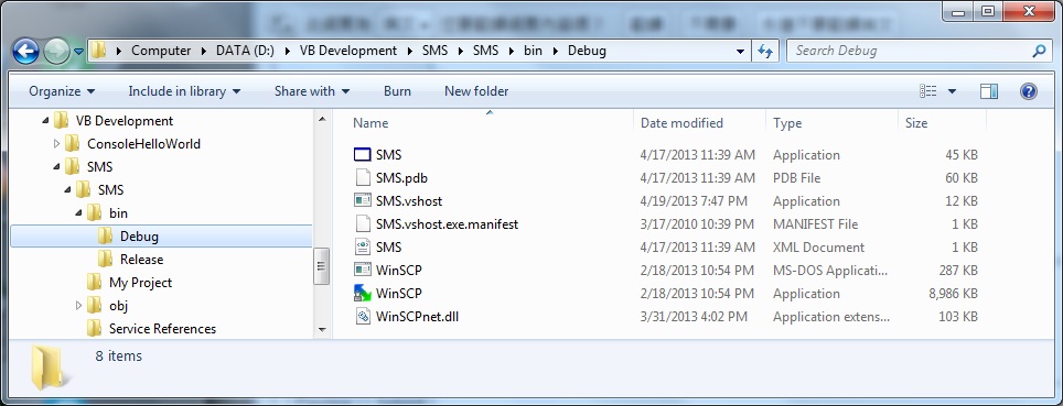

However, I have read the page https://winscp.net/eng/docs/library_install#vs before and have renamed the dll file as suggested before including in the reference.
Also, I have copied the exe file to the debug folder but the problem is not yet solved.
Thus, I made this post and would like to have advice from you all experts.
Please also find the attached screen capture of my vs debug environment for reference.
Would someone advise on this?
Thanks so much!

Have you tried to debug this using fuslogvw?
gsclarke
Many thanks - that tool did the trick. The problem was that the Winscp.* files were not in the project's bin/debug directory where I was running the application from. I then stumbled onto the next problem with the invalid manifest error. There seems to be a bit of confusion with the install instructions...
According to the instructions, the DLL must be renamed to winscpnet.dll (anything other than winscp.dll to avoid confusion with winscp.exe) and then added to the project as a reference. However, the invalid manifest problem was solved if I renamed the file back to winscp.dll.
I just need to sort out my sshhostkey value and then I can confirm if everything is working properly.
