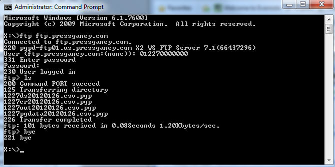

Whether I try to use my script or the GUI the connection to this host it can take up to 10 attempts to finally make the connection. However, when I try to use just the FTP tool within my windows 7 PC it connects immediately. I have tried SEVERAL times to work with the vendor but they could care less to help me and look at their logs. They just keep pointing the finger at winscp. They don't care if it's a burden to me as long as they get their files.
WIndows 7 CMD ling FTP screen shot Attached...

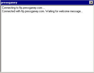

When I try to connect to the host using the WINSCP GUI it has taken up to 10 attempts before it finally can connect to the host...Here is that log...screen shots attached.

Description: This is the screen shot of the GUI waiting to connect. Then after this it reconnects. This repeats up to 10 ten times before it will eventually connect.

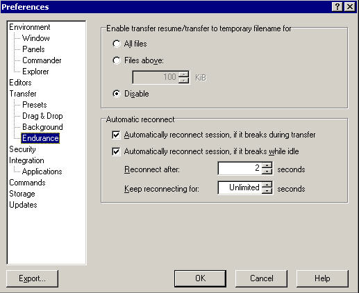

Description: This is the screen shot of the endurance settings for the host I'm trying to connect to.
Description: this is my windows 7 pc FTP screen shot that can conncet immediately to the host.

Have you tried setting the timeout to longer interval than 15 seconds?
Note that Neil is using SSH (SFTP or SCP), while you are using FTP. So his suggestion is not releated to your problem.
lravens19
Hey Martin thank you for your response. Are you talking about the endurance settings? Currently "reconnect after" is set to 2 seconds and "Keep reconnecting for" is set to unlimited. Is there another setting you are referring to?
