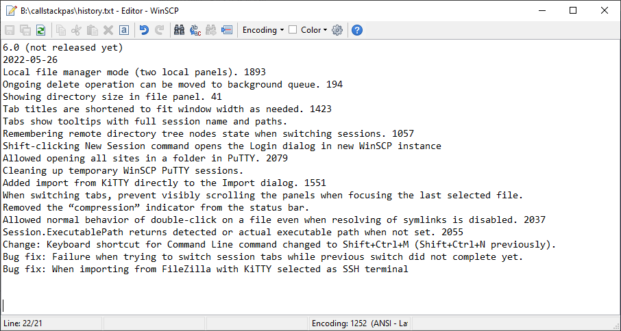

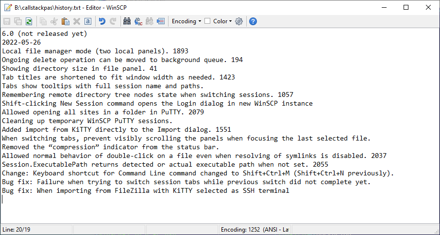

  1. I open a file in an editor (local file if it matters). The contents is small enough to fit the window. I press Ctrl+End to move the cursor to the very end.

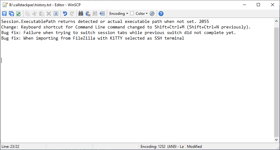

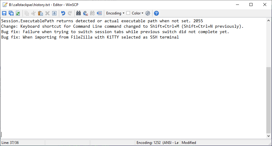

  2. I press Enter several times to add empty lines so that the contents does not fit anymore. The original contents scroll out of the view and the vertical scroll bar appears.
  3. I press Back several times to remove the empty lines. The scrollbar changes with every deleted line as expected.
  4. Once I delete enough lines for the whole contents to fix the window, all contents scroll to the view and the scrollbar disappears.
Screenshots of all four steps are attached.
What version of Windows are you using?
Ok, I see. So the problem is that deleting the last line should scroll the view up, so that the cursor stays on the bottom of the editor, to match the scrollbar.
