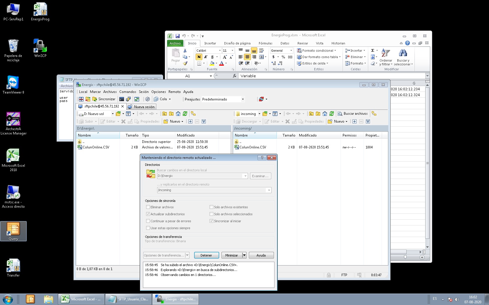

WinSCP gets disconnected without showing any error message.
paulo2019%%
Hi. We are using WinSCP to upload continuously a file into an SFTP site, The process of keeping the file updated works well most of the time, but frequently (once or twice a week) WinSCP gets disconnected without showing any error message. We star again WinSCP and the connection gets back. But some hours or days after, the issue happens again.
Win SCP: Version 5.17.6 (Compilation 10516)
We are using Windows 7 on the PC
Screenshot attached
Thanks and Regards
Paulo Aravena
Description: The names of the attached files show what are they for.
  • WinSCP version.jpg (319.44 KB, Private file)

What does the "gets disconnected" look like? Does the dialog close? And session tab as well? Or does WinSCP close completely? Can you post a session log file for that?
paulo2019
Chile
Re: WinSCP gets disconnected without showing any error message.
Hi Martin. Thanks for your reply. I mean that WinSCP stops working without showing an error message. Just the windows showed in the screenshot above. I am afraid that I can`t get the log file.
One more thing. I am not a specialist in this area. If you can tell me where to get the log file, then I can post it. Thanks.
43,049
And what happens then? Does the interface freeze? Or does it disappear?

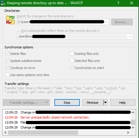

Same problem happens to me.
Intro/Environment:
Same problem happens to me. It often closes the whole client in "/keepuptodate" mode without visible notification.
- Updated to native portable (with local WinSCP.ini) WinSCP 5.17.6 and *.7 on Win10-1809. Applies also to at least 5.13.9 (tested). Does NOT apply to 5.11.3 (works fine, my previous "stable" in use).
- Using a connection via SFTP-3 to a Linux server (no admin access). As the server closes idle sessions, I use SSH NUll packetes each 60sec. in my profiles.
- I am running WinSCP from command line:
start "" "winscp.exe" "mysession" /keepuptodate // "%LOCALPATH%" "%REMOTEPATH%"
Problem:
The older WinSCP version 5.11.3 worked fine so that after any server-timeout the client stayed open in the background with disconnected state and as soon as a new change in the local directory was recognized, the auto-reconnect kicked in (incl. Win10 Notification-Bar Message). You can see this in the screenshot - notice the red message indicating an auto-reconnect. But this does not work any more since at least the mentioned versions or even since 5.12 (not tested). Instead the client disappears/closes without any notice, which is annoying if you need stable "realtime" sync of the remote location.
Do I miss any (command-line) option with the new version(s)? I have enabled "Debug 2" logging and noticed, that during a common session via standard GUI the client logs the network event lookups each second incl. the SSH keepalive (NULL) packets each 60 sec. Those connections never die. But using the dedicated "/keepuptodate" GUI from command-line with the same saved session-config (60sec. NULL keepalives) there is no logging of any SSH keepalives. So I assume there are no SSH keepalives sent in this mode (Why by the way??). However, this is just a side effect I noticed. The main problem is as described before, that the client closes silently on disconnects without waiting in disconnected state and doing an auto-reconnect on the next local filesystem change.
So... bug or feature? :D
Here are some logs before the client GUI terminates. I won't be able to provide full logs due to to much confidential data in it. But these snippets should tell you where to look for the issue, I hope. :)

Description: Screenshot of working version 5.11.3. Notice the red message indicating an auto-reconnect. Missing behaviour in newer versions.
martin1234guest
Re: Same problem happens to me. - sorry, wrong attachment...
