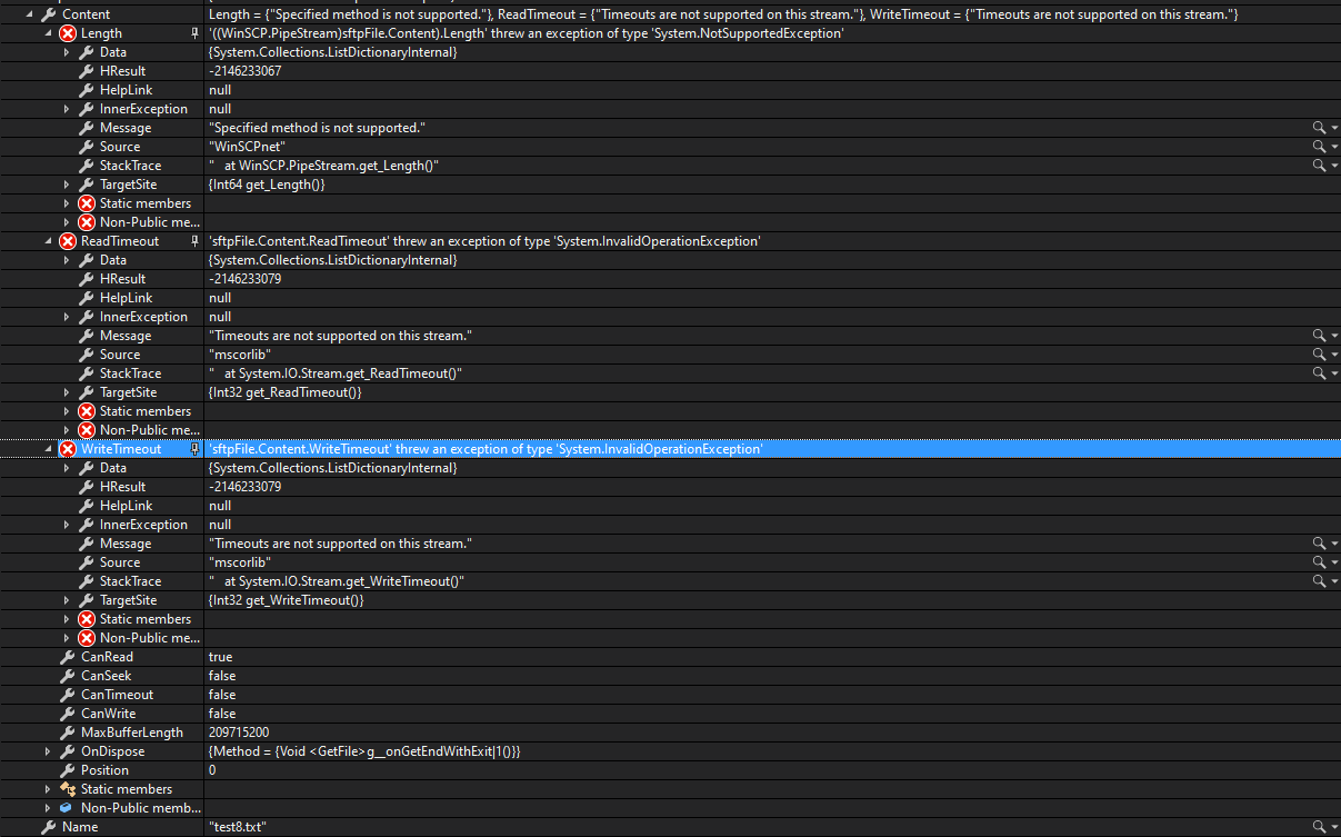

I'm using the WinSCP 5.18.2-beta Version and I want to download a file via SFTP protocol to stream.
For .NET Standard 2.0 as well as for .NET Framework I´m getting the same errors.
After calling session.GetFile the stream has errors you can see in the attached file StreamErrors.PNG.
Than after calling session.Close the following exception is thrown:
Exception:
System.InvalidOperationException: 'Recursive calls not allowed'
Stack:
at WinSCP.Lock.Enter()
at WinSCP.Session.Dispose()
at ..DownloadFile(String remotePath) in ..\Sftp.cs:line 97

I have also tried to use session.GetFileToDirectory and it works perfectly fine.
So I don´t know if there´s something wrong with my code or could it be something else?
