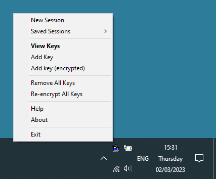

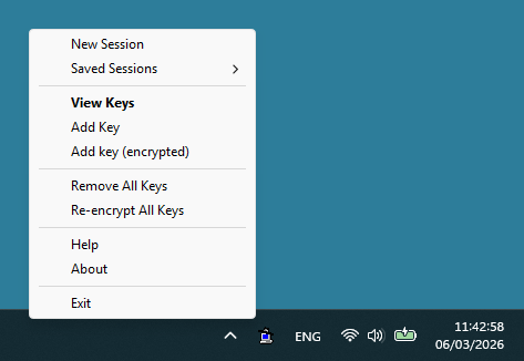

When you run Pageant, it will put an icon of a computer wearing a hat into the System tray. It will then sit and do nothing, until you load a private key into it. (You may need to use Windows’ Show hidden icons arrow to see the Pageant icon.)
If you click the Pageant icon with the right mouse button, you will see a menu. Select View Keys from this menu. The Pageant main window will appear. (You can also bring this window up by double-clicking on the Pageant icon.)

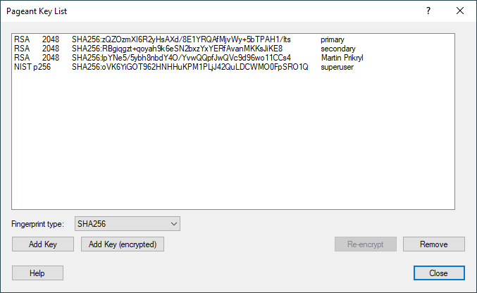

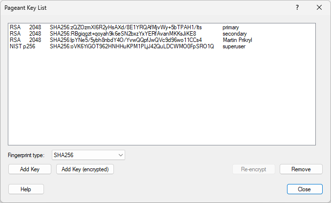

The Pageant main window appears when you left-click on the Pageant system tray icon, or alternatively right-click and select View Keys from the menu. You can use it to keep track of what keys are currently loaded into Pageant, and to add new ones or remove the existing keys.
The Key List Box
The large list box in the Pageant main window lists the private keys that are currently loaded into Pageant. The list might look something like this:
Ed25519    SHA256:TddlQk20DVs4LRcAsIfDN9pInKpY06D+h4kSHwWAj4w
RSA  2048  SHA256:8DFtyHm3kQihgy52nzX96qMcEVOq7/yJmmwQQhBWYFg
For each key, the list box will tell you:
  • The type of the key. Currently, this can be RSA, DSA, NIST (an ECDSA key), Ed25519, Ed448, or SSH-1 (an RSA key for use with the deprecated SSH-1 protocol, not supported by WinSCP). (If the key has an associated certificate, this is shown here with a cert suffix.)
  • The size (in bits) of the key, for key types that come in different sizes. (For ECDSA NIST keys, this is indicated as p256 or p384 or p521.)
  • The fingerprint for the public key. This should be the same fingerprint given by PuTTYgen, and also the same fingerprint shown by remote utilities such as ssh-keygen when applied to your authorized_keys file.
    By default this is shown in the SHA-256 format. You can change to the older MD5 format (which looks like aa:bb:cc:…) with the Fingerprint type drop-down, but bear in mind that this format is less secure and should be avoided for comparison purposes where possible.
    If some of the keys loaded into Pageant have certificates attached, then Pageant will default to showing the fingerprint of the underlying key. This way, a certified and uncertified version of the same key will have the same fingerprint, so you can see that they match. You can instead use the Fingerprint type drop-down to ask for a different fingerprint to be shown for certified keys, which includes the certificate as part of the fingerprinted data. That way you can tell two certificates apart.
  • The comment attached to the key.
  • The state of deferred decryption, if enabled for this key.
