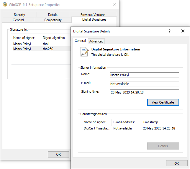

Verifying Integrity of Installer
Optionally, as a security measure, you can verify an integrity of the WinSCP installer binary before installing.
In Windows File Explorer display Properties of the installer and verify a signature on the Digital Signatures tab. The installer should be signed by “Martin Prikryl”.
The EV certificate used to sign the latest installers is valid from 2020-02-10 to 2023-02-17 and has the following SHA-1 thumbprint (hash): fb845245cfbb0ee97e76c775348caa31d74bec4c.
The certificate can also be displayed on the User Account Control prompt, when starting an installation for all users.
