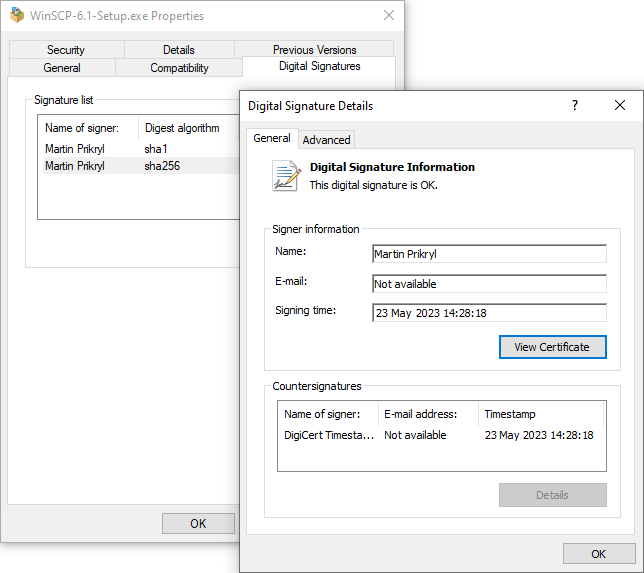

Verifying Integrity of Installer
Optionally, as a security measure, you can verify an integrity of the WinSCP installer binary before installing.
In Windows File Explorer display Properties of the installer and verify a signature on the Digital Signatures tab. The installer should be signed by “Martin Prikryl”.
- The EV certificate used to sign the latest installers is valid from 2020-02-10 to 2023-02-17 and has the following SHA-1 thumbprint (hash):
fb845245cfbb0ee97e76c775348caa31d74bec4c - The certificate that was used to sign older installers was valid from 2016-11-17 to 2020-01-23 and has the following SHA-1 thumbprint (hash):
0b3d1c21773b6fd78fbf418a5ea2d91c0e5144d3
The certificate can also be displayed on the User Account Control prompt, when starting an installation for all users.
You can also verify file integrity manually. Find checksums of the installer binary in the release notes or on the installer download page. You can cross-check the checksum against a copy of the release notes on the SourceForge server. Use the certutil tool to calculate a SHA-256 checksum of the downloaded installer and compare it.
