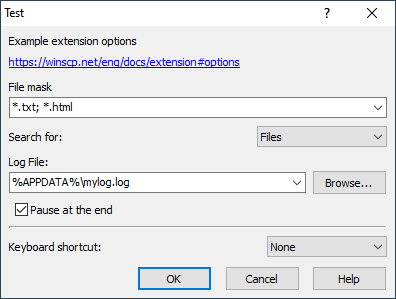

For example the following entries:
# @option       - -config label "Example extension options"
# @option       - -config link https://winscp.net/eng/docs/extension#options
# @option       Mask -config textbox "&File mask" "*.txt; *.html"
# @option       SearchType -config dropdownlist "Search for:" -files ^
#                   -files="Files" -dirs="Directories" -both="Files and Directories"
# @option       LogFile -config file "&Log File:" "%APPDATA%\mylog.log"
# @option       Pause -config checkbox "&Pause at the end" -pause -pause
Produce this options dialog (the Keyboard shortcut option is added implicitly):
When the option names are used in a command like:
example.exe -mask="%Mask%" %SearchType% -log="%LogFile%" %Pause%
The resulting command (with the options configured as shown on the screenshot, i.e. with the default values) will be:
example.exe -mask="*.txt; *.html" -files -log="C:\Users\username\AppData\Roaming\mylog.log" -pause
