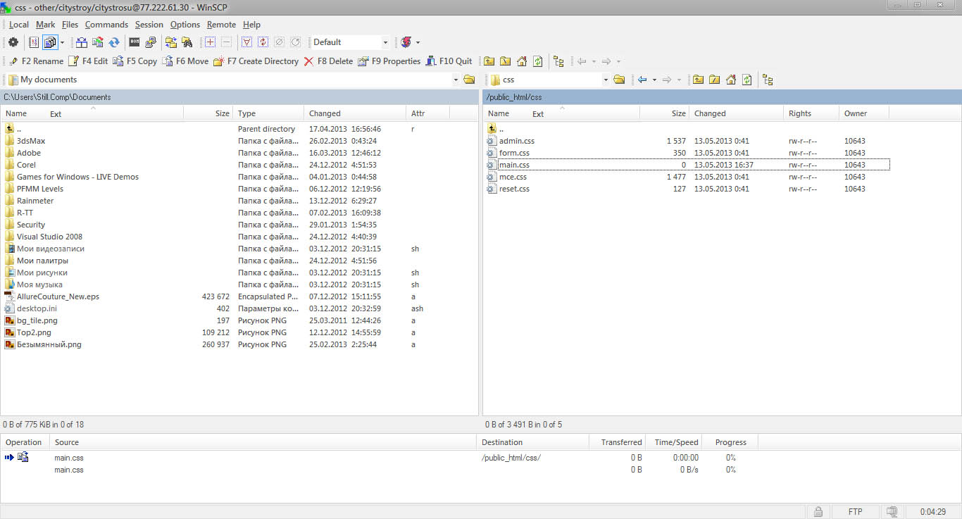

Infinite Uploading File
I want to save file form text-editor, or upload direct from left panel and i got a 0% infinite uploading file. When i reconnect file on the host is empty :(
I update WinSCP to last version, but the problem remains.
the problem persists with other hosters. In the panel, these files are tranferred well.
Description: screenshot
stillborn
Re: Infinite Uploading File
Yes. This problem occurs intermittently and include regular upload or save from editor.
The only solution I've found - to change the file and save as long as the load does not go(google translate =\ )
But this solution does not always work
