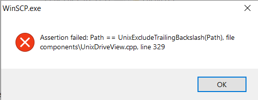

Using S3 protocol, when accessing a directory in a S3 bucket which contains 172 folders and 5633 files, after a while an out of memory error appears. Accessing the same bucket via SFTP is working without any issue.

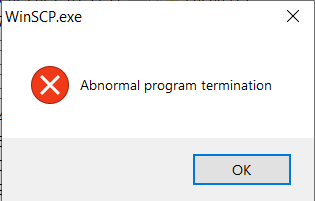

It's not always the same error, see also these three reports:
https://winscp.net/forum/viewtopic.php?p=104948#104948
https://winscp.net/forum/viewtopic.php?p=104949#104949
https://winscp.net/forum/viewtopic.php?p=104950#104950
The following error couldn't be reported using the Report button in the error message.
Error:
(0041C284)
(0041C284)

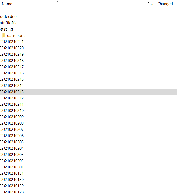

The issue is related to the display, see attached screenshot. When hovering with the mouse over it, the display is updated. Let me know if you need a session log.
