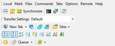

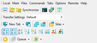

Customizing Toolbars
Some of the toolbars are initially hidden. To show them (or hide the visible ones) go to View > Toolbars in Explorer interface or Options > Toolbars in Commander interface. You can also use context menu of the toolbars. Note that you cannot hide toolbar with the main menu. You can hide unwanted individual toolbar buttons by going to Customize Toolbar submenu of toolbar context menu.
If you do not like order of the toolbars rearrange them using drag&drop. You can even drag them to other edge of the window or make them float outside. If you want to avoid accidental rearranging of the toolbars, lock them by going to View > Toolbars > Lock Toolbars in Explorer interface or Options > Toolbars > Lock Toolbars in Commander interface.
The most important toolbar buttons have text labels. To hide the labels go to View > Toolbars > Show Selective Text Labels in Explorer interface or Options > Toolbars > Show Selective Text Labels in Commander interface. In the same menu under Toolbar Icons Size, you can configure size of the toolbar icons.1 This feature is available only in the latest beta release.
For example see some of the toolbars of the Commander interface.

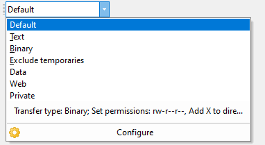

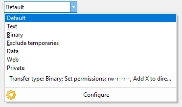

Transfer Settings presets
On Transfer Settings toolbar you can override default transfer settings by selecting one of the configured presets. Note that the first option Default represents default transfer settings.
