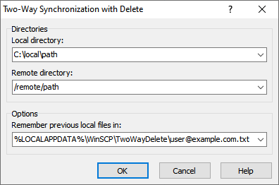

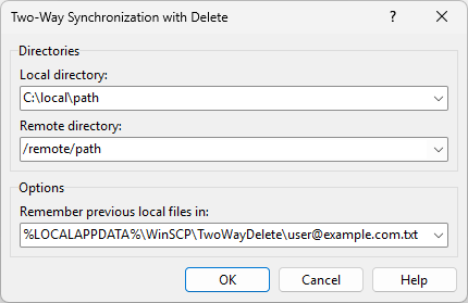

Options
Directories
Enter root directories for the synchronization into the two directory boxes. By default the current working directories will be used. The directories can be specified, when executing the extension only.
Options
In the Remember previous local files in box, specify the path to a list text file that will be used to remember the files that existed after the synchronization. The file (and its parent folders) are automatically created, if it does not exist yet. By default, the file is stored in %LOCALAPPDATA%\WinSCP\TwoWayDelete and named after the current session. This options are available, when executing the extension only.
