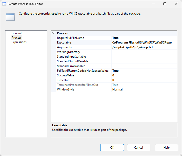

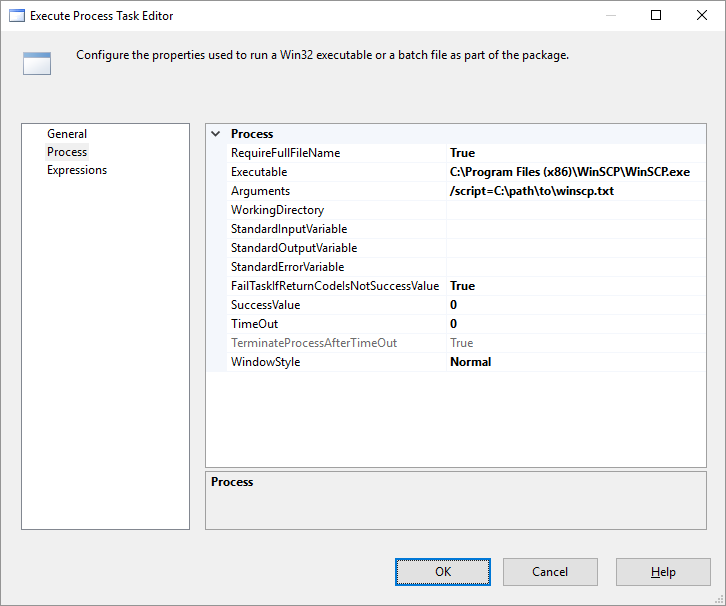

In SSIS/SSDT, add new Execute Process Task to control flow of your package. In the Execute Process Task Editor:
  • Put path to WinSCP executable (by default C:\Program Files (x86)\WinSCP\WinSCP.exe) into Executable;
  • In Arguments specify /script=<pathtoyourscript> (Alternatively you can specify all commands here using /command switch, as used the command-line template that WinSCP can generate for you);
  • You may want to set WorkingDirectory to path, where you want to download files to/upload files from, if you do not use absolute paths in your script.
